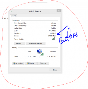

I picked up my new Surface Pro 3 at local BB yesterday. I was using the SP3 for good hours. My SP3 is connected to Netgear R7000 and I got link speed around 700+mbps. I did the system update and I think it did the firmware and OS update. Now, my wifi link speed shows 6mpbs. Yes, that is six!!! I have tried everything, reboot the router, reboot the SP3, removed wifi setting and re-add.. I am still getting only 6mbps. Has anyone seen this before? Can someone check yours? Did you do the firmware update(it took good 10 min to update)? Thanks in advance...

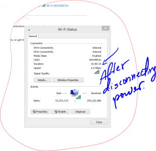

It appears to be something to do with Power Management, as it at least for me impacting on battery, plugged in I'm getting 600-850 Mbps on battery drops as low as 6 Mbps but bounces around 300-600 Mbps but at times gets stuck at 6 or even stops responding.
That's what I think too

If the wifi is throttling to save power than I am okay with that. This feature should be clearly spell out. Perhaps it did in design spec some where. Like I said, it's freaking me out. I just want to be sure my device is not defected. I will to do some testing with power plug.

BTW: @ctitanic, Thanks for pic illustration. I always like the visual.
[UPDATE]: I did a quick test. Yes, with the power plug in. I can see my wifi speed is back ~700-800Mbps again... :)
