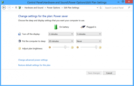

Sort of, but not exactly. You can define one of your Power Plans to blank the screen after a certain amount of time. I've set the Power Saver mode to do so after 5 minutes of inactivity. You can also set the device to require a password when waking the screen back up. The only way to >always< require a password on screen wake is with a registry edit, without it all someone needs to do is move the mouse, touch the screen or press a key to get full access to your device, a blanked-out screen isn't the same as timing out to the lock screen:

You can set your power options to not sleep/hibernate and use something like monoff to shut down just the display.

The SP2 doesn't have connected-standby. If you blank the screen on a SP2 it's not 'sleep'ing, there's a separate setting for that.
