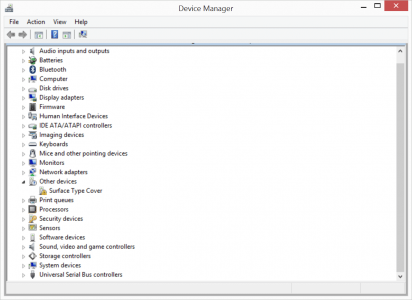

Alright, so the update history showed that all the updates passed without failure. Here is screenshot of the device manager:

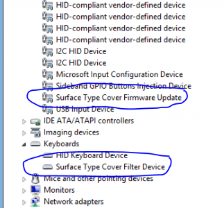

Your Surface Type Cover is not showing up in device manger then....it should list Surface Type Cover Filter Driver as well under the Keyboards entry...
What happens when you go up to View and select show hidden devices?
It should look like this. Be sure you attach type cover, otherwise it won't show up.
The cover is attached. Definitely a hardware issue then? Or could this be a missing driver issue?
My take: You shouldn't have to do anything to get the type cover to work. It should just work. It seems like you have tried many different things. If this was a non-Microsoft keyboard, then I would lean toward the driver. At this point, I would think it is HW issue. It might be your SF3 or it might just be that specific type cover. It could be bad contact. I would bring your device to local Microsoft store or Best Buy and test it out.
I would take the entire set back to a Microsoft Store so they can test to see if it is the cover or the Unit....if you put a new one on it works it was your cover, if it doesn't it is the unit....
Alright, I'm planning to visit a place with a Microsoft Store next week anyways. I'll bring it have them check then. Thanks again everyone for all the advice and help. Man, I really like this Surface too. Ah well, I guess there were gonna be some problems with a big roll out.
Thoughts? I've refreshed and rebuilt the Surface Pro 3. I have had our Vendor send a replacement surface and type cover and still no luck. The driver will not install. I assume bad hardware..... I try manually installing the Surface Type Cover Filter Device Driver and I get "This device cannot start. (Code 10)"
