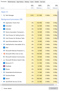

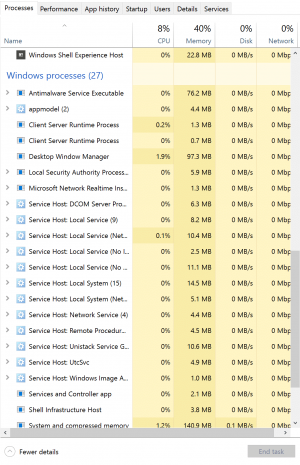

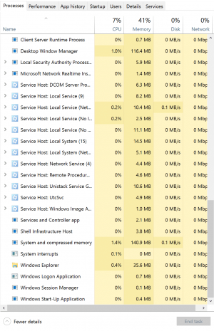

Here is my list of installed applications, please let me know if you find something that is cutting my SP4 battery life:
View attachment 7891 View attachment 7892

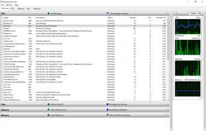

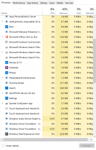

And here is a list of all my running apps as we speak as well as the apps that start up with my SP4.
View attachment 7893 View attachment 7894

Basically, if that pic of your Task Manager is a representative sample of your typical idle/light load, then you are probably suffering battery drain because your CPU cannot properly idle due to all of those background tasks that add up. It's not that any particular one is high but that there is that much demand from so many programs. If you go to the Performance tab of Task Manager, you'll see the current clock speed of your CPU. If your CPU isn't spending most of its time under ~1 GHz (for the Core i5, ideally 0.5-0.7 GHz), you will have < 6 hour battery life. I've been more closely monitoring my true battery life lately (as seen in this thread: Tracking Battery Life), and, so far, I'm getting somewhere between 6.5-7.5 hours of battery life but with CPU usage usually < 3% when I'm not actively doing anything but still have programs open. When I check my CPU clock speed, I'm generally under 1 GHz with momentary but regular spikes into the 1-2 GHz range. If you could post a summary of your CPU usage and clock speed, that would be great for getting an idea of whether the battery drain you have is due to the CPU not idling.
