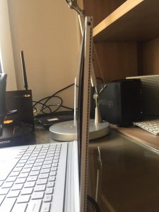

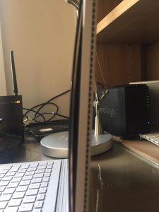

My Surface Book 1 has started to show a very noticeable yellow line on the right side of the screen and a couple of spots at the top. Also I noticed that when closed the screen doesn't sit flush to the screen so I looked at the top of the screen to see it actually bows outward in the center. I measured the curve to be 3mm. After paying over AU$4k on this device I was hoping it would last more than 2 years. Planned obsolescence?

My Surface Book 1 also started to bow after about a year and a half, I would always just throw it in my bag, I think a combination of the hing gap and the constant pressure against my back caused it. Luckily I purchased the extended warranty and was able to get it replaced / sell it to buy the 15".

And now the yellow streak has grown and screen has started to bow outwards like Lars Mitchell, not quite as badly but when closing it the middle of the screen now touches the keyboard. Just been quoted $600 for a refurbished replacement. Ouch!
