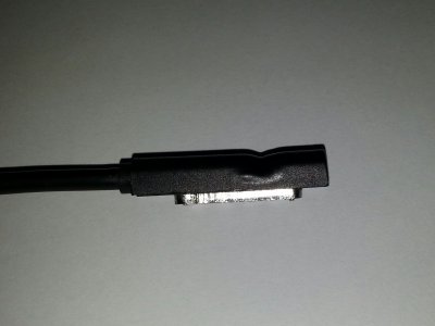

I haven't bought a 2nd charger for my SP3 yet, but I bought a few for my SP1 off ebay.
One stopped working, one melted and the other is still OK.
The problem with 3rd party for the SP line is that no reputable brand makes them. They are all no - name manufacturers, so it's a bit of a lucky dip.
I would advise not leaving it charging unattended if using a 3rd party.
This is my SP1 charger from eBay that melted. I pulled it out when I saw it melt as I was looking at it. It was really hot.
