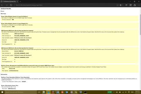

I've let my battery completely drain and recharge. I also finally ran an powercfg/energy test and got these warnings. The power policy doesn't bother me; it's those USB warnings that do. Should I uninstall the USB drives and reinstall them? Can anyone help me figure how to fix them? Thanks!
Do you have a microSD card installed. That looks suspiciously like an SD card issue.
I don't have anything in the device. I've also just used the computer for 25 minutes of light usage and it's already down 4%. Do you think this would be the culprit to my battery issues? Should I take it to the Microsoft Store?
4% in 25 minutes may not be all that bad. You need to go through 1 or 2 charge cycles before you get a good read.
So do you think I should get my computer looked at with those warnings on the USB? Or is there anything I can do about it?
