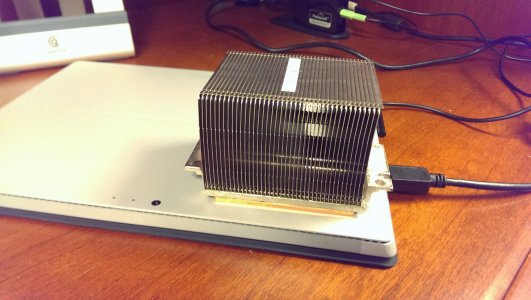

How about this? I had an old heat sink lying around from some broken machines so I was playing around with this concept. It actually does work where the heat sink did get warm and pull heat off the back of the SP3, but since it was flat, the built in venting probably didn't work as well as it should have.
I've actually tried this with a copper heatsink and it did get warm but provided no real performance boost plus its much heavier and bulkier than a fan but it does use less power ;)
Well, I don't have access to a 3D printer, so I don't have the luxury of making my own fan attachment. Since the heatsink is a passive one, it probably doesn't work as well as the fan, but in combination, it might be a better solution.
The problem with a heatsink is that the thermal transfer will never be adequate enough unless you use a thermal compound which would make using it a little inconvenient. But don't let me talk you out of it, see what you can do.
Wait....now we're talking about putting HUGE HEAT SINKS on the SP3???!?! Really??
No offence but let people do what they want with their stuff. If mohcho wants to strap a heatsink to his SP3, let him. I for one won't be but that's my prerogative.
I was just messing around with it to see if it would help. By no means am I thinking of strapping on the heat sink to my SP3. Having a desk fan blowing at the back of the SP3 works better.
