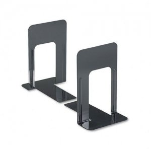

I have had some luck using stamped metal book ends as tablet stands:

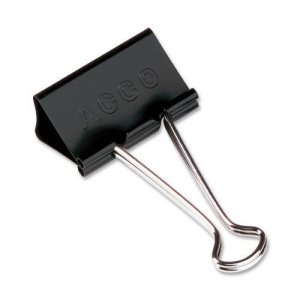

To prevent the tablet from slipping off, I just clamp a binder clip on the front edge.
$2. Looks like crap, but works like a champ with any tablet in both Portrait and Landscape mode. Lightweight and simple surely, but not portable.
