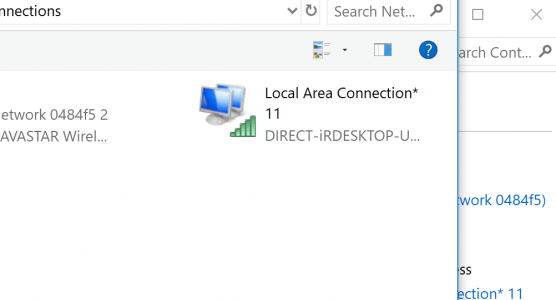

While it is trying to connect this local area connection pops up, then disappears. See the attached image. It pops up for a second or two.

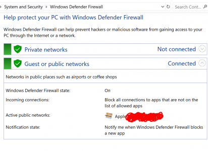

Okay, is your WiFi connected as a “Public” or “Private” network? Must be “Private”, I believe.
Got it set to private and not the "no internet" is back even though I can surf the web fine. I think I'm just going to use AirParrot. Thanks anyway for the help!
