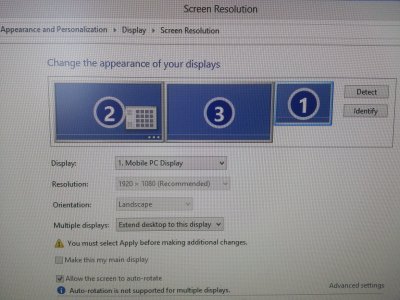

Just a quick update, I successfully setup dual external monitors by doing 1 monitor with the Mini Display Port, and 1 monitor with USB3.0 adapter.
The monitor on the USB3.0 is the same resolution, but you can tell it is a little slow at times.

Is that a total of THREE screens or TWO screens? I.e. is the Surface Pro tablet screen replicated on one of the monitors?
That is a total of 3 screens, 1 being the Surface Pro's. So 2 external DELL Monitors with Displayport, and the Surface Pro's monitor.
I should have made my question more clear. You have the surface pro screen, and two extended displays. So you can have three different documents (one on each screen) loaded at the same time?
Yes. You can have 3 seperate documents on each. 3 SEPERATE displays.
