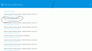

jrapdx
hello guys, could help to fix this problems? thanks

Hi, my sp2 failed to install 10/12/2013 firmware update and has been working OK up until today when it failed to install 18/01/2014 firmware update. After that it was showing plugged in not charging 0%. I followed vol+ and power button press for 15s, as on: How to Fix Surface Pro 2 ?Plugged In, Not Charging? Error but no joy. Then I did it again after removing type cover and bingo, restarts with battery apparently all OK. The firmware update 18/01/2014 then succeeded and all seems good again (fingers crossed).
