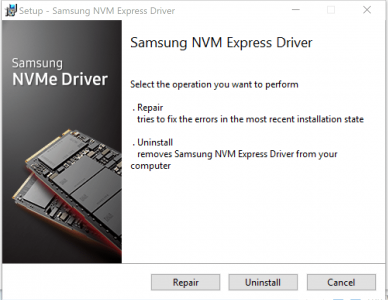

Have you tried downloading and installing the latest Samsung NVM Drivers? Here is a screen shot of the installation / repair of the software on my machine. I noticed a definite positive performance spike in my machine after installing it. See Pic - Hope this helps. If you cannot find the file for download - message me and I will send you a link or the file itself zipped up, in an email.

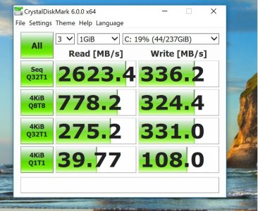

i didnt see any changes on my still super slow. is that values the same for all the 250 gb models??
