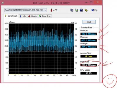

Thanks ctitanic - the steps you outlined in this thread worked for me with the excellent before and after results.
