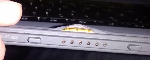

Mine is just over a year old, and in the last two weeks has split near the connector due to using it 'undetached', that is folded back with the keys facing outward - as you refer to as the 'official' way.
I confidently say it is due to this, as the way is it split makes it obvious where the tension was.
The difference between the official way and the 'detach it, rotate so the keys are against the back of the SP3) is that the 'official' way bends the hinge flap 90+22=112°, whereas the 'unofficial' folds it 90-22=68° : less tension means it will likely last longer for the effort of rotating it.
I've used it detached/unofficial mode quite a bit too, and no ill effects that way, so if I were starting again I'd get in that habit.

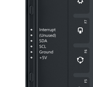

Reversal should be benign, as you mention it doesn't work(power) in reverse here's why.
http://edwardsh.in/keyboard cover/2015/02/23/probing-a-surface-touch-cover/
The pinout is not reversible however since an unused pin would mate with ground when reversed there will be no power.
Note: Some earlier reports indicated the keyboard connected via a modified USB 1 port. Obviously that was not correct.
