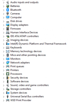

Thanks so much for your assistance! I did do a firmware update last week to see if that would help, but unfortunately it didn't. I'll remote into my user's Surface when she's out of the office to check the power management. I just pulled up device manager on my side ... where can I find the Windows Power Management (see attached screenshot)? Or should I go in through the Power Plan Settings section?

Each device in Device Manager usually has a "power management" tab. See if you can uncheck the box for "allow windows to power this device off to save power" for either the Surface Pro Dock Port, Mini Display Port, or even the USB port. See if that helps. Otherwise, usually, if you use the "high performance" plan in power management, it is supposed to essentially do this same exact thing. Let me know what you find.
Ah -- gotcha! I found that tab on a few of the devices! I'll try both options -- disabling that and also the high performance plan. Thanks again for your advice! I should be able to attempt this tomorrow!
