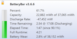

I have just done a quick test and started a 1080p video encode to max out the i7 CPU on battery.
This is the current discharge rate:
No wonder the 36w power supply cannot keep up. It is using over 10w more than it can supply.
Plug in the 36w adapter and sure enough it drains at -10000mW under the test
Plug in the 65w adapter and it CHARGES at 15000mW under the test
