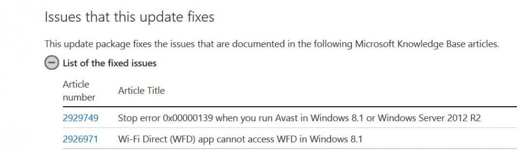

It has something to do with the windows updates I did today. According to Mocrosoft they did sth with Wifi Direct... but I dont know exactly what.

You could try uninstalling that update.
Go to Desktop, hold the start button a few seconds, select Programs and Features from the menu
Go to View Installed Updates, select the update and uninstall.
