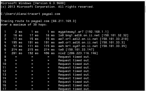

Just spoken with westnet- they jumped on remote access.
Confirmed it is nothing in my modem settings and appears to be a security issue.
The lady from westnet would type ping paypal.com in command prompt and it would time out.
She tried another secure website (a bank) it also timed out, lastly trying yahoo.com and this worked although she stated yahoo.com is also a secure website.
I jumped on my iPad and again PayPal loaded so westnet couldnt work out what was going on, by paypal loading on my ipad this confirmed it isnt a block through my home internet but definitely some setting in the SP3.
lots of sites are configured to not respond to Pings, any support person worth their salt would know that.
I don't get any response to a Ping of paypal.com either.
