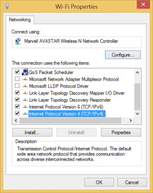

I just thought of something else as I was putting the DNS instructions together ...
Try turning off the IPv6 in WiFi Properties, it's not going to work with an old router anyway and might cause a problem.
1. At the Desktop Press and Hold or right click the Windows Icon in the lower left corner, then select Control panel from the popup menu
2. Tap or Click "Network and Internet"
3. Tap or Click "Network and Sharing Center"
4. Tap or Click "Change Adapter Settings"
5. Press and Hold or Right Click the Wi-Fi adapter and select Properties
6. Scroll the dialog box and uncheck "Internet Protocol Version 6 (TCP/IPv6)"
OK or Close that and try connecting to paypal

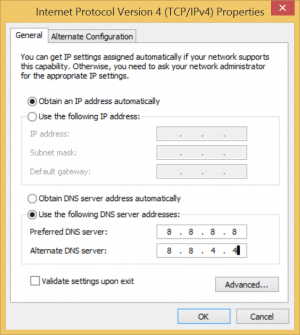

To change the DNS follow the above steps 1-5
6. Scroll the dialog box and select "Internet Protocol Version 4 (TCP/IPv4)"
7. Tap or Click Properties button
8. Tap or Click "Use the following DNS server addresses"
9. Enter 8.8.8.8 in the first box
10. Enter 8.8.4.4 in the second box
11. Tap or Click OK.
See how that works...
