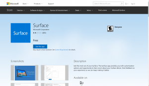

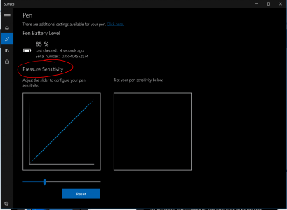

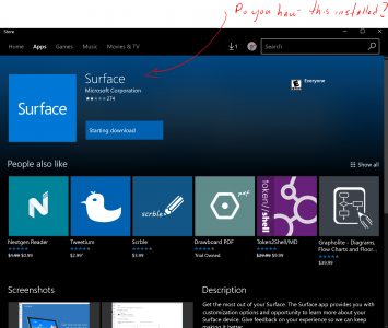

Hello DoubleFelix - Do you by chance have the "Surface" application downloaded? Have you by chance attempted to adjust the sensitivity from there? I agree with SharpUser that each program may have it's own sensitivity / pen setting built in - BUT in the chance that is does not have one built in, the program at hand may rely on the Surface Pro 4 settings. I have sent along some pictures that will hopefully help you. One other thing - When I opened the MS Store app and did a search for "Surface" - the store did not render the result I was looking for - (This could just be my machine of course) So I had to do a separate search until I got here ( Surface – Windows Apps on Microsoft Store ) and then I used this link to open the MS Store and Poof! The Surface application was available for download.
Once downloaded - it's pretty much self-explanatory - I hope this helped you just a little - Please let me know if it did, or what you did to resolve your issue. I always love to learn about the SP4.
