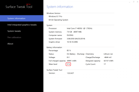

Dear all,
I got a trouble with my battery on surface pro 3. I don't know why my battery wear up to 5% after 1 month using. Last Friday only 2.1% but today is 5%. I remember I read somewhere said that battery can be restored by itself but I didn't see this. I also uploaded a photo about my battery attached with this topic. So could you help me deal with my trouble ?
Thank you for you help.
P/s: forgive me if my English is not good.

Welcome to the forum
My guess is that the rapid change to 5% was an anomaly. It doesn't (yet) seem like you should be overly concerned about it. How may hours a day do you use your SP3 and how often do you charge it?
When I first got my device, my battery's full charge capacity was 1-2% above the stated design capacity. After a couple of months (and a refresh), my full capacity reading now fluctates between -0.5 to -1.5% of design capacity. Apparently this is normal, and more importantly, I'm getting about nine hour of usage on average, so I'm not too worried about it.

I use it everyday. Normally I charge 1 time per day, may be 2-3 times double in one day. However I also used surface when it was charging. In Saturday and Sunday and someday I used more than everyday, I plug adapter all (actually often ^ ^!). Normally I use surface 6 hours per day. At weekend is 9 hours. My surface battery life is around 4-5 hours.
Not sure the system is all that accurate regarding "battery wear", even though the "tweak tool" extracts the number recorded by Windows. I wouldn't be concerned right now about that - check it again in a week or so.
Thank you, I will check it again after 1 week. I also read this problem in surface pro 2 thread but I still worry. 1 month before no problem but only 3 days I got 5% with battery wear. How can I believe >.<.
I didn't check the full capacity so I don't know at the first time but I checked after 1 week using and I saw full battery per charge some time go up and down (the highest is 43,574 mWh) but never lower than Design Capacity (42,157 mWh), it starts to go down under Design Capacity few days ago after I recharge at 3% battery life. It begin with 0.2% of wear and then 1.5% for next charge, stop here 2 or 3 time and now is 5.1%.
the system is not very accurate at reading battery wear. one day mine was at 7.5% then the next couple of days it was down to 3.5%. so I wouldn't pay that any attention
Actually now I'm confusing because it fluctuates at period time but now is not :(. I also used powercfg /batteryreport /output %USERPROFILE%\Desktop\battery_report.html in command prompt to check battery and got the same result. Today I charge and it can't charge up to 100%, it's stop at 96.6% :(. I will pay attention for one week to check battery all again :(.
Are you using BatteryBar to get that reading? If so, that's normal. It only charges up to the current capacity and if that's lower than the last reading, it will be below 100%.
If you're using the default battery meter, then something's wrong.
I am using Batterybar v 3.5.2. The full capacity within 5.1% battery wear is 39,991 mWh. When I charge, my surface stop at 96.6% of full capacity = around 38,600 mWh. That's why I don't understand. I've already drained down to 10% and now recharge again to check it.

Thank you, I've already fixed my problems by replacing SP3 and got the new one. My battery in the previous SP3 is die few weeks ago and I have contact with MS supporter to replace it.
