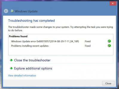

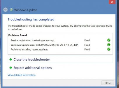

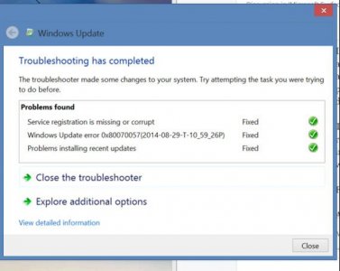

I'm not sure if this is related to the problem, but here's what happens when I run the troubleshooter 3 times in a row.
