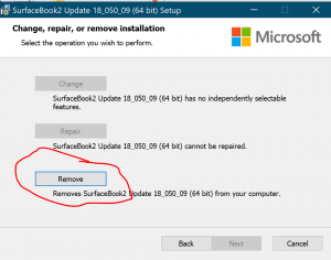

Have you tried to un-install/reinstall the Surface Pro 4 Drivers? If you can, use the link below to download the latest drivers for your machine. Once downloaded, open the file, when prompted - remove (See picture) , reboot, then of course - reinstall. Hopefully your machine won't freeze up before you can get to this.

I would definitely try to reload the Surface Drivers as mentioned above before you reload your machine. Please let me know if this helps, or I can be of any further assistance.
