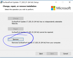

I have had to completely replace my Surface Pro 4 after a year of usage due to screen issues. Your issue however is something I have seen before. I am going to suggest that you....
1) Download the latest Surface Pro 4 Drivers from Download Surface Pro 4 Drivers and Firmware from Official Microsoft Download Center
2) Once downloaded, open the file and either Update or Remove the Surface Pro Files - REBOOT / Then Re-Install the drivers.
Please pardon me if you have already attempted this. I have found that by doing this, more often than not this resolves many of the software / hardware issues. A few questions.........
