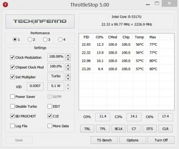

** Of course, proceed at your own caution. This works well for me but if you brick your rig it's on you...
Your Surface pro runs a cpu that can throttle back pretty dramatically - down to about 800 mhz. This is mostly to save battery life.
There is an app that allows you to stop this throttling. It is aptly named "Throttlestop". Basically it allows you to run your Surface Pro at close to Turbo speeds all the time. I use it when I am plugged in and turn it off when I need to be on battery for a while. One benefit I have noticed is that web pages load much faster more consistently.
You can download it here:
Downloads | Tech|Inferno
Get the version 5.0. There is no setting to have it start with Windows so you have to either set that up in Scheduler or manually start it when you want to use it. It then runs from your Notification Area as a little stop sign icon.
Here are the settings that seem to work best for me. The setting I would recommend NOT messing with is voltage. You are not really overclocking your Surface Pro, just disabling throttling and placing it close to Turbo Mode most of the time.
* One note regarding the benchmarking tool included. The lower your score the better. So even though it says "high score" it really means "best score".

I mentioned this in the OP but I'm guessing you didn't read it so I'll say it again. You are NOT overclocking your SP, merely running it closer to Turbo Speeds all the time instead of it down-clocking to a crawl. My SP has never gotten over 80C doing this and believe me, Intel CPU's can go to 100C plus before you need to even begin to worry about cooking one off. The worst this should do to your rig is lowering your battery life, but then again, you can do as I suggested and turn it off when you will be on battery for a long time.
Right now I'm running Netflix at 2.22 Mhz and 61C. For me this actually runs cooler at higher speeds than stock. Nevertheless, proceed at your own risk. I've been running this without issue for over a month now.

You may be able to do that with this tool. I'm not going to mess with the voltage but Google "Throttlestop undervolt" and see what you get. One nice thing about this software not starting up with Windows is that if you screw something up and BSOD you won't be caught in a reboot death spiral.
