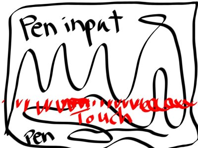

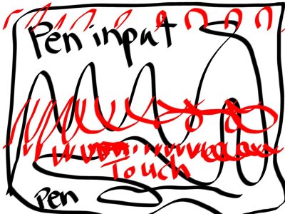

Ok, I did that and it actually got worse. I reset the calibration have done it several times and rebooted and same thing. This is how my screen is working now. :(
So the pen works fine, but the touch input only works on the top and bottom half of the screen. There's a dead area across the entire middle/top quarter of the screen. I have attached some screenshots.
I still can't close metro apps. This is very annoying. Everything was working perfectly until I calibrated the screen.

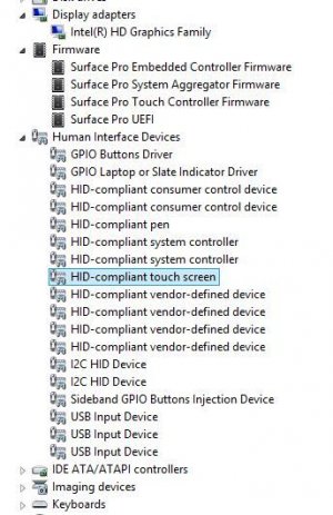

Which driver? There's a Surface Pro Touch Controller Firmware or the HID-compliant touch screen. I attached a screenshot of it.
I even reinstalled the N-TRIG update from June. I'll remove it and reboot and reinstall it manually.
I removed the system update from last week as well, and the same thing.
I'd start with the Touch Screen itself, first. Then, if that doesn't work you could try the firmware.
