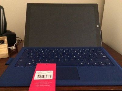

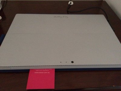

Update: I think the trackpad in contact with the touch screen while charging is causing it for me. Here is a fix that works for me: a piece of cardboard to cover the trackpad.
