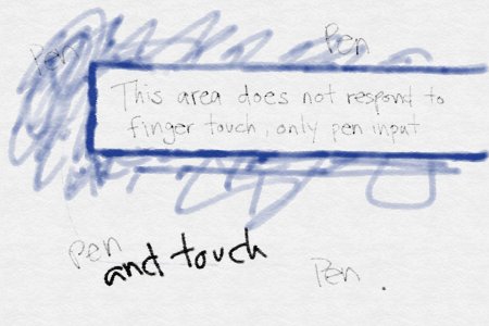

I've attached another picture of the current state of the screen touch input issue.
Does anyone know if NTRIG has calibration software for the SP3? I've looked on their site and it's pretty sparse.

I refreshed my SP3 and the issue remained. Since all my installed applications were gone, I decided to reset it and go back to factory settings and the issue still remained. I'm installing all the updates again to see if it will hopefully fix it, but I think I'm going to have to call it in as a hardware failure on the screen.

Got on the phone with them and the guy asked me to go into the advanced recovery options which takes you out of Windows and the screen still not respond, which points to a hardware problem. He called a local store and confirmed that they have stock and made an appointment to get an exchange for a new unit. Kind of annoying that all of this happened, but what are you going to do.

Just an update, I went to the store, the guy looked at it and confirmed the issue, he went to the back, pulled out a new box and voila, brand new SP3, charger and pen. Everything looks good so far, just had it doing all the latest updates, etc.
