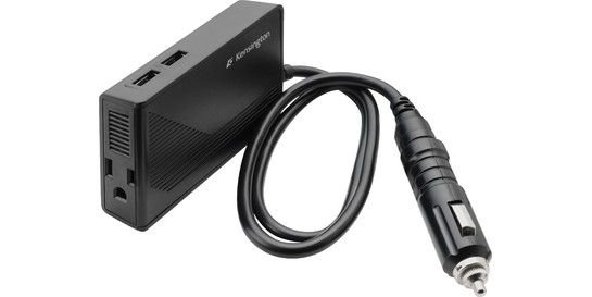

Speaking of inverters this looks like it may be what MS wants you to use for $69.99 and looks very nice actually. Kensington Auto/Air Power Inverter with USB Ports - Microsoft Store Online
