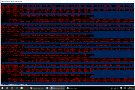

so....the code did the attached...
SFC /SCANNOW didn't work either
I think you may need to try another refresh. Something seems to have gone wrong somewhere unless it's a security app you may have installed.
