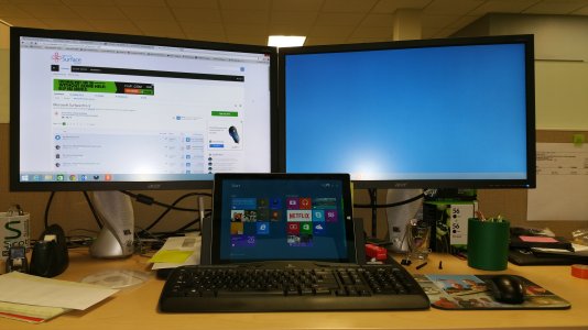

I have 2 Acer V233HL monitors connected to Startech adapters - 1 USB and the other miniDisplay, plugged into my dock. It works perfect for what I need. I dont run any graphics intense programs. My SP3 is i7, 8GB, 512GB
