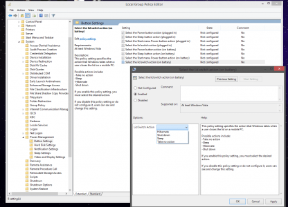

This won't get you there completely and mohcho's answer is great, just supplementing it a little bit. You can get a little more advanced control by going to gpedit.msc (you can just type it in the start menu) then Computer Configuration>Administrative Templates>System>Power>Button. You will have all kinds of things you can configure for power button, and so on. However the closest option there is sleep, which with connected standby is close since it is still kind of running when it goes to sleep but not exactly what your looking for. This goes a little further than the Power Options which can be aggravating if you want to do something that gpedit can do that it can't.
