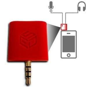

I have used this successfully on both SP2 and SP4 to connect 3.5 mm audio headphone + mono microphone simultaneously:
Amazon.com: Rockit Headphone/Microphone Splitter: Electronics
I bought a Creative X-FI GO Pro! which is an external USB sound card - my Rode mic now works like charm. Just plugging into the Mic jack and it's perfect :)
I think that's the solution. It looks like the MS or Realtek doesn't properly parse a TS plug in its TRRS as a microphone. I suspect (though can't confirm) that it may see it as a mono-out. I have an old Tascam iXZ interface for the iPad/iPhone that converts a TRRS jack to worh with an instrument or mic (w/ phantom) plus headphones. It's basically the same at the Rockit, but with phantom power and some impedence matching.
