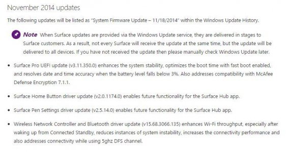

Anyone know what component is likely the culprit of this firmware problem? Perhaps I can identify what version I have on that component, to explain why I don't have the bug.
Do you have all the firmware updates installed?
Edit: I'm guessing it's an issue with the Surface Pro UEFI.
