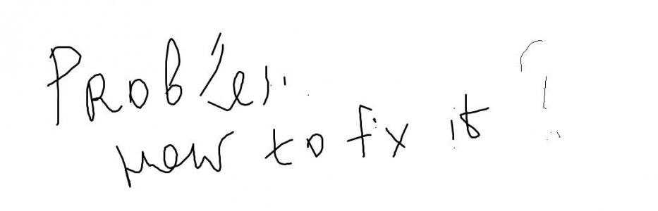

Can anyone tell how to fix a problem when pen is writing with gap missing some parts of line, like in screenshot below?
Already reconnected pen, also checked battery and button, everything is correct besides gaps.

1) Do you get a similar gap when using your finger to write?
2) When you use the on-screen keyboard, handwriting option, with the pen or finger, do you also have this problem?

In both cases with finger situation is alright, with pen the same gap-story(
Okay.
Next step is to isolate a pen hardware problem.
1) Are you using the pen made for the Surface Pro 4/Surface Book? This is the Surface Pen (V4), not the pen with two buttons near the tip.
2) Do you have a friend or acquaintance with the same pen? If so, it would be very beneficial to ask that friend if you could temporarily pair their pen with your Surface Pro 4. You would have to in-pair your pen first, then pair their pen and test. Of course, this is inconvenient, but very helpful to avoid unnecessary worry about the computer or pen that you own.

1) Pen made for the Surface Pro 4
2) I don't( I only got to know that a pen from ASUS doesn't work with Surface)

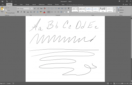

So I decided to put my pen to the test since I just got a refurbished Surface Pro 4. It has Windows Version 1607 (OS Build 14393.969) all updated etc. I opened Microsoft Word and went to town with the pen. Initially the pen did skip intermittently, so I kept on drawing / spelling out letters etc. I then closed Word without saving and reopened it and did the same thing but this time the "skipping" went away and I got fluid lines without any breaks.
I have gone back a number of times with no line breaks or skipping. I doubt this helps you since I don't know what, if anything transpired on my machine.
