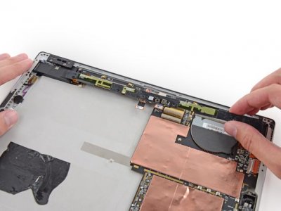

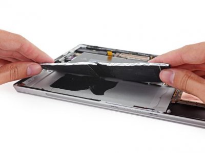

The battery is wide and flat and covers a good portion from the left side to past middle. the right side is the logic board. Most likely the charging circuit is heating while charging.
Here you can see the battery removed and the logic board on the right.
