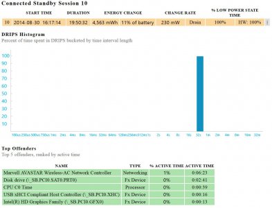

When doing a sleepstudy, I noticed my SP3 had been in Connected Standby for 19+ hours. See attached screenshot.
I then tried to manually hibernate it using command prompt "shutdown /h." However, when I came back to it a few hours later, it woke right back up as if from connected standby, so I ran another sleep study, and sure enough, it had been in connected standby.
So somehow it seems as though my SP3 cannot hibernate. I understand that after 4 hours in connected standby, it should automatically hibernate. But mine never does. I have see connected standby durations of 11, 15, and 19+ hours.

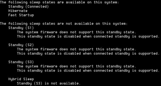

Edit: I've also attached a screenshot showing the output of "powercfg /a" which shows that the system is allegedly capable of hibernating...
