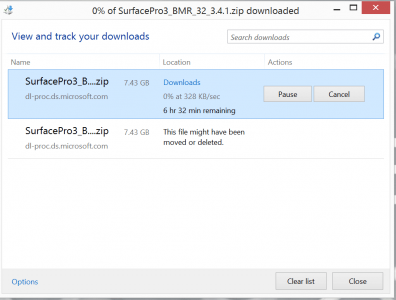

I finished downloading and the zip file was immediately deleted by IE with the message
"This file might have been moved or deleted"
...seriously?
Some googling shows that windows defender causes it to automatically delete exe zipped files?
Is there a way to retrieve the deleted file or do i have to redownload the entire thing?
...seriously?
That is strange, Defender isn't doing that on any of machines, Open up Windows Defender and see if it has been quarantined and restore it from there....
the list is clean. There's nothing under the quarantined list.
wth...
i'm going to retry it on the laptop that the surface was supposed to replace.. sigh..
I highly doubt Defender would have snatched it. Something is not making a lot of sense. It should have "just worked".
here's a screenshot.
I disabled windows defender realtime protection and i'm downloading it again.
