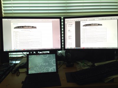

i got two of these monitors, daisy chain them and everything went as expected. you need to switch inputs manually, and need to switch the monitors to dp 1.2 to drive both.
the dell cables work perfect...
edit: i got the U2713H, sorry.
So there is hope...However.. I may have a slightly older model, as I have no DP out for Daisychaining, and no option to switch DP version to DP1.2?
